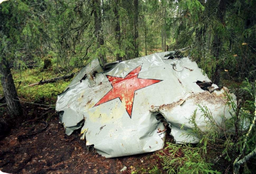

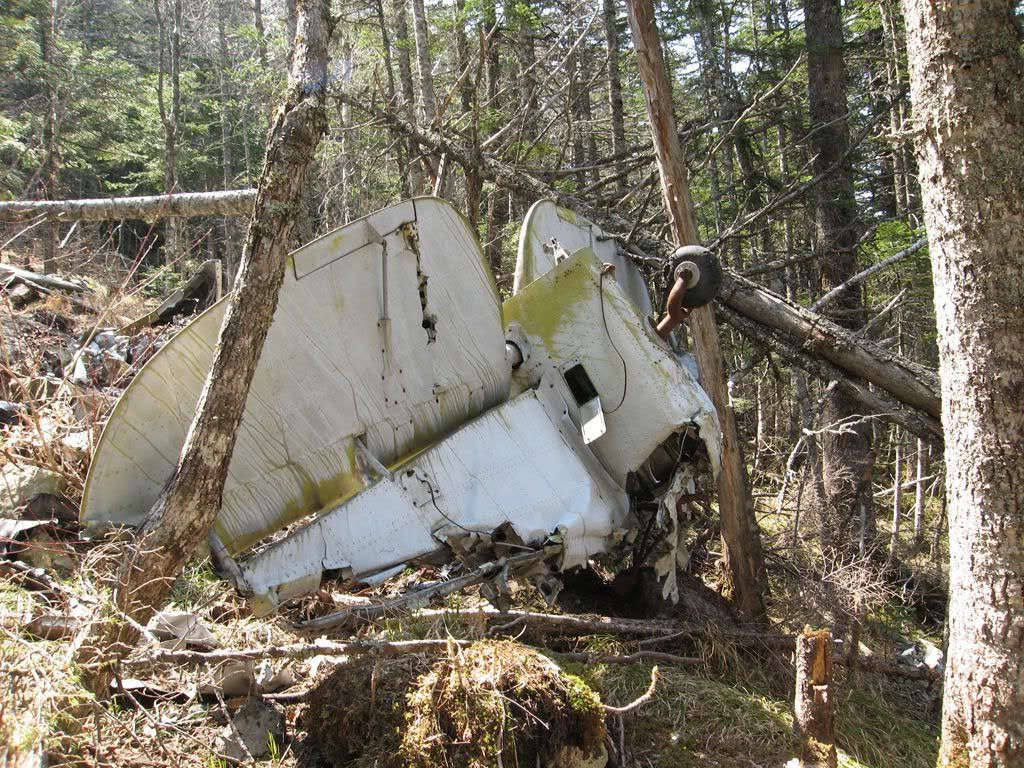

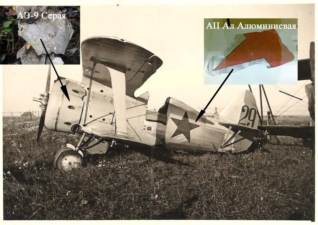

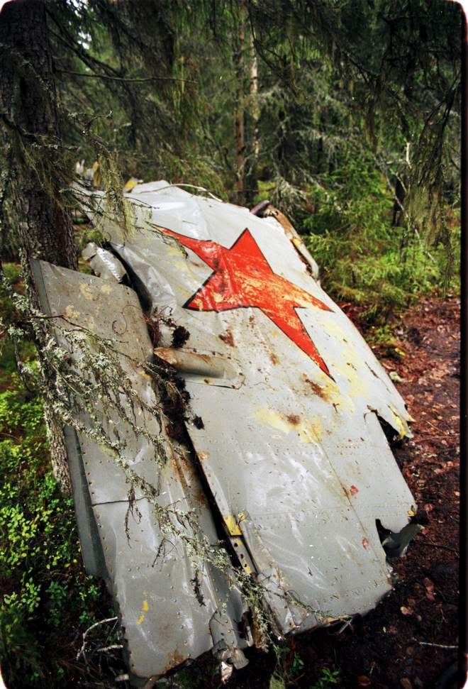

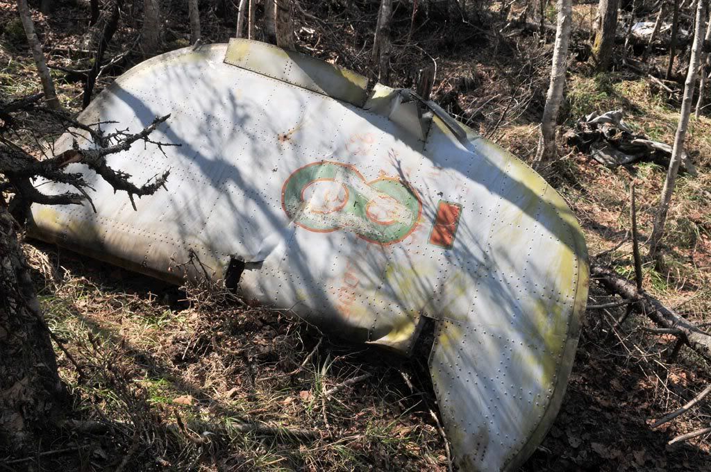

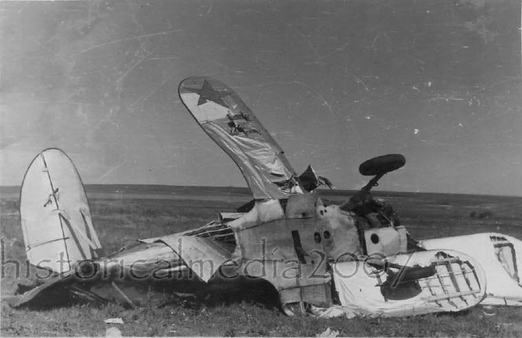

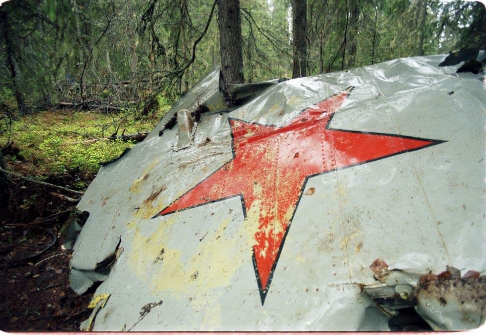

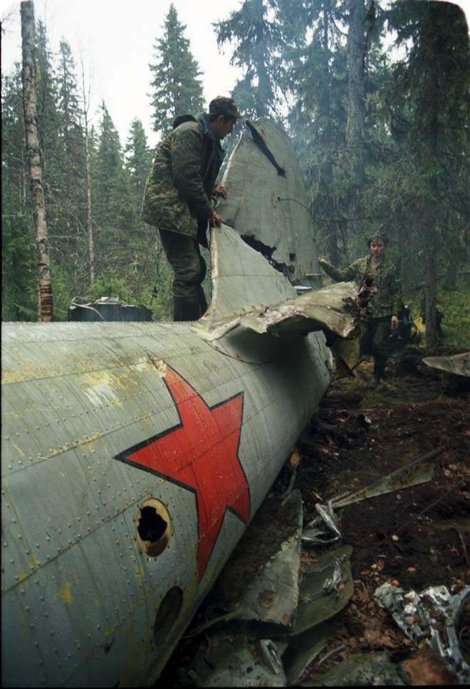

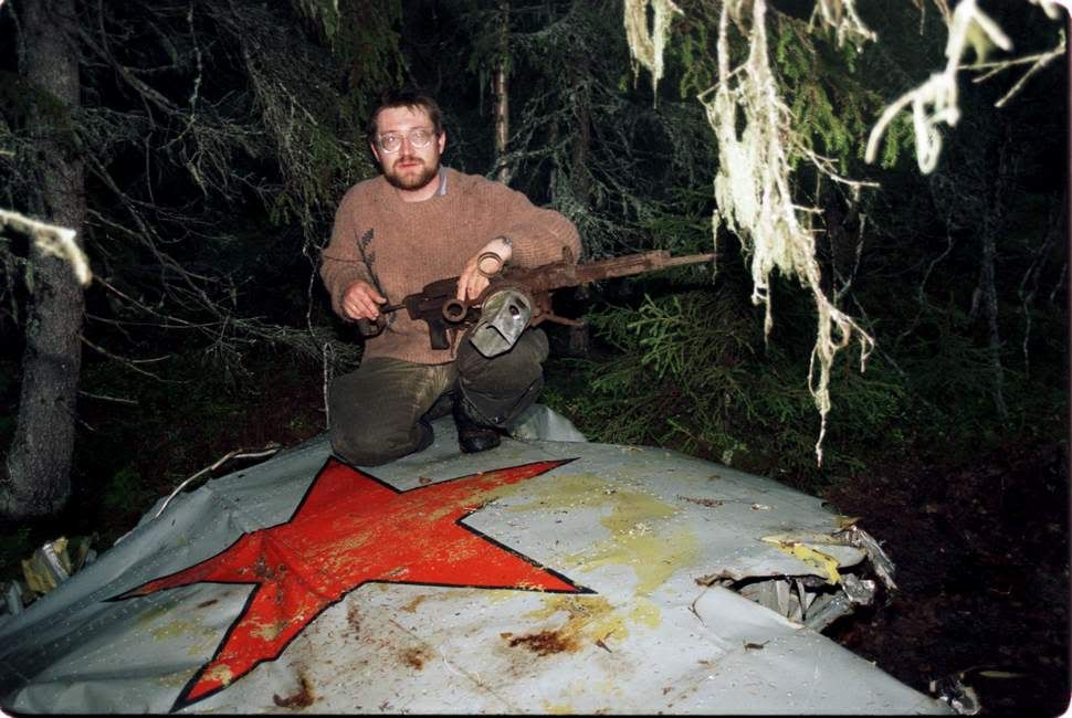

Gray AE-9 paint mentioned in “Prospekt po remontu” was widely used on SB bombers. Following photos should help to get an idea what colour was oil enamel AE-9:
Spanish SB probably made in early 1938:
Winter War relic from Finish museum:
Another finish museum:
WWII wreck from Estonia:
WWII wreck from Karelia:
1942 Pacific Coast Wreck (thanks to Psy06):
Unfortunate wreck found in Archangelsk Region in 1999:

Metallicheski detalyi (kapot, obtekatelyi, lyuchki I t.p.) = (glyantsevaya) svetloseraya AE-9
Tkanʹ i fanera (lodka I krilya) = (sherohovataya) nitrokraska aluminievogo tsveta NAK
Volnistye linii (zmeya) = olivkovo-zelenii tsvet AII Z ili AMT-4
Fabric and metal were painted with two different paints: metallic nitro paint for fabric and glossy oil paint for metal details. You should try to show different textures of those two paints.
Good examples for two-paint practice (gray for metal and silver for fabric) are I-153 and undersides on some I-15bis
NAK was probably the same as “aluminiyevaya” AE-8
