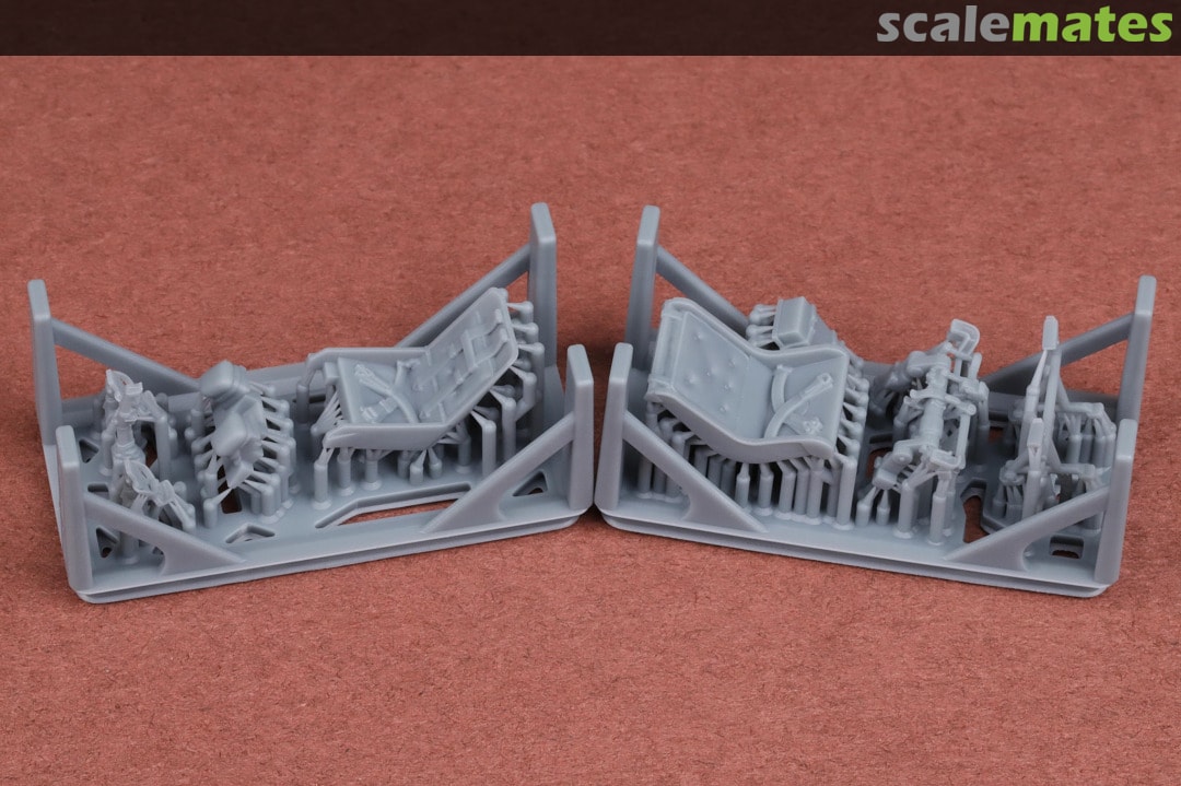

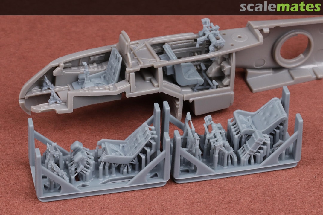

https://www.scalemates.com/kits/sbs-model-72081-messerschmitt-me-410-cockpit-upgrade- parts--1519852
