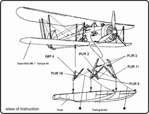

И у свордфиша towing bridle
https://www.cmkkits.com/res/archive/059/007007_05_026268.jpg?seek=1197971376
